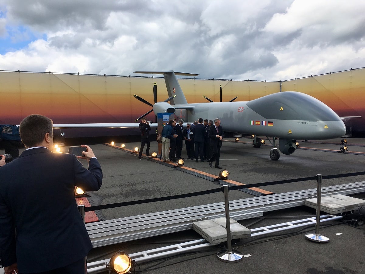

Not only twin engine UAVs are uncommon, but
"What makes Eurodrone different from any other drone is that it is civil certification-ready,” said Francisco Sanchez Segura, Airbus executive vice president and head of engineering."
It looks like an RQ-4 Global Hawk and a Piaggio-Selex P.1HH got a child together.
Not sure whether it's ultra safe or the EU is just over-bureaucratic.
Anyway, with a drone that large, I can't really see an armed version being of particular use.
As an oversized platform it is better used carrying dedicated payload rather than munitions, to increase its endurance.
At its weight class the only weapons that are viable are long range munitions.
Europe needs new MALE drones and to make them cheap. Heavy HALE is too much of a niche, albeit an important one.
