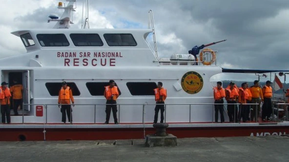

Again a good example why Indonesia (BAKAMLA) needs more patrol boats which are large enough to handle a helicopter and to operate for many days in rough seas
A fishingboat and a cargoship collided with each other, 17 of the fishermen are still missing.
