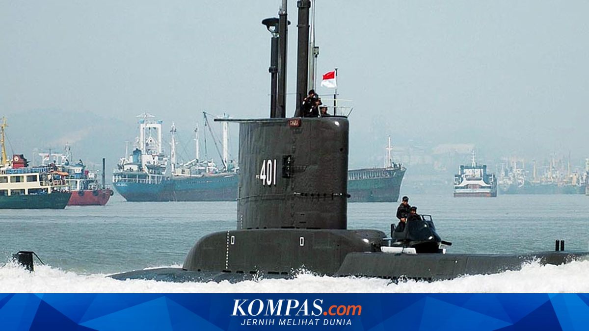

Video from Kompas TV on the Nanggala salvage operation progress. The effort from Chinese vessels to lift heavier parts like the conning tower/sail section has not been successful yet. Their calculation that the conning tower/sail section weight 18ton, turn out not accurate. Seems with the force of impact, significant portion of Nanggala parts already covered by ocean bottoms. This seems required more lifting capabilities to release them.
The sonar finding shown some kind of crater near the location. Whether this is related or not, still has not been confirmed. The condition of Nanggala shown result related to rapid decent. TNI and MinDef seems determine to continue the salvage operation. The need to find what really happened Important Politically, as the voices to do audit on Submarine operation and overall maintenance getting louder.
Other media site shown TNI-AL and Chinese team only manage to find Bow, Stern and Conning Tower/Sail section. The main fuselage/Pressure Hull has not been located. The worries is the hull complete covered in mud of ocean bottoms, or worse fall into the crater near the location.
This's getting more complicated.
