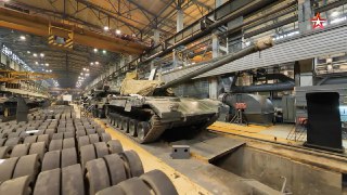

Some sped up production footage from UVZ. The factory is plugging at near it's full capacity. We can still see some BMPTs and T-14s in their halls, though they are certainly a minority.
