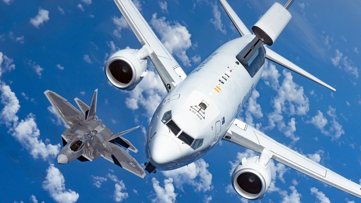

Unless there is some dramatic difference in capability between the Wedgetail and the GlobalEye, the GoC will NOT be able to sole source this like they did with the P-8. So, there will be a competition, and given the heavy emphasis on industrial offsets, it will be pretty hard this time to disqualify the GlobalEye. Also, Saab has a pretty decent footprint in Canada already. That, plus the Bombardier component, is a pretty hard act to follow. Will be interesting to see the final outcome.
There are some pretty dramatic difference in capability. Between the two.
The planes are quite different. A single E7 engine has about as much power as both of the Global Eye's combination. The E7 has two 90Kva generators. The 737 is a large commuter jet that has space for ~100 seats, while the Global Eyes BG6000 is like a 17 seat plane to start with. Conversion to a AEW reduces that dramatically, and one becomes a long endurance, long range platform for complex battlespaces, and the other becomes a minimally manned platform for short observation flights much like the El2085. The radar on the E7 is more advanced, more powerful (it is the most powerful radar flying), has way more processing capability, way more send receive capability and is 3+ times larger. It has other capabilities including sigint and electronic warfare.
The G550 EL2085 vs the BG6000 based Global eye would be a much more comparable match up.
The E7 is in another league. It would be like comparing a trainer jet, to a F-35. A trainer jet can fly, some have a radar, some can carry munitions, and some can even fire them. But it isn't an F-35. It isn't designed to go into a straight up peer fight and win. It can slot in with coalition partners, who operate the same platform, can use the same training pipeline, can work jointly with other pilots and jets and ships and munitions.
A large country would almost always choose the E7. For flights over its own territory, or for long range deployment and for the capabilities.
Plus the US and UK are acquiring and operating them, they having huge sums of money thrown at them to increase their capabilities. They have been impressive in the middle east and Europe. They will be able to integrate into the US/UK/AU/JP battlespace management systems.
They aren't the same thing. They aren't in the same universe.

Its not just about size, or power, or range. Its about software and processing, and integration. You need something that can fly 500-100km away from the front line. No development of the fighter jet or space sats will ever replace that.
If you go Globaleye or similar, sure, there is some capability, there, but its very different. It is much more like the older E3 in terms of it being able to do some traffic control in the air, particularly for forces that don't have high level integration and ultra modern systems as small ops can be coordinated from that platform, but its not the same as the E7.
The E7 is a enabler of and order of magnitude greater. If you want to operate F-35's and low observable munitions in a battlespace, you will want the E7.
It also has way better endurance and operational tempo capabilities. 4 E7's would likely be able to operate more, cover more, control more, than 8-12 smaller AEW aircraft.
The 737 platform itself, is extremely durable and cheap to operate and maintain. The people thing is always a major concern, but the E7 requires only fractionally more manning, even with just 10 consoles, they don't all need to be manned. Which is another strength. Buy the plane, and there is already a massive pool of operators from Australia, Korea, Turkey, UK and the US to fill seats on any deployed mission. The computer systems are very much next level, with huge effort put on integration between systems like Aegis, Cooperative engagement capability, general battlespace management, F-35, weapons, ground stations, satellites etc. These are flying daily along Ukraine, along Turkish boards in the Mid east, along the Korean front line. Nothing from Europe offers that. Which is why NATO is buying E7's. How many global eyes are currently flying? How much money have they poured into the platform? How much combat has it seen? What is its development potential?
But acquisition costs are definitely a thing. But work share, you can basically do all of the refurbishment and fit out in Canada. The airframe is not the main game in this build.
If you want to increase Canada's aviation industry, get Air Canada to cancel 4 of their 737 max order instead, and buy 4 used 737's. Then force air Canada to buy and operate BG6000. This would also be dumb, but not as dumb as not buying the E7 because the Global Eye might have potentially, perceived, more workshare. Life time costs and operational costs would be likely greater on the Globaleye, while offering much inferior capability.
An E7 can remote fire weapons from fighters or ships, guide those weapons on complex trajectories to avoid threats and detection, while also scanning for drones and smart munitions, listening and then degrading enemy radars and communications on planes, ships and ground and space, while, moving at 900kmh, across thousands of km2 ever second with hundreds of aircraft in the air in a mix of military and commercial airspace, with essentially un-jammable coms/radar and do it for 12 or more hours, all day every day. From full high intensity peer war, to sanctions to just observation to intelligence.
