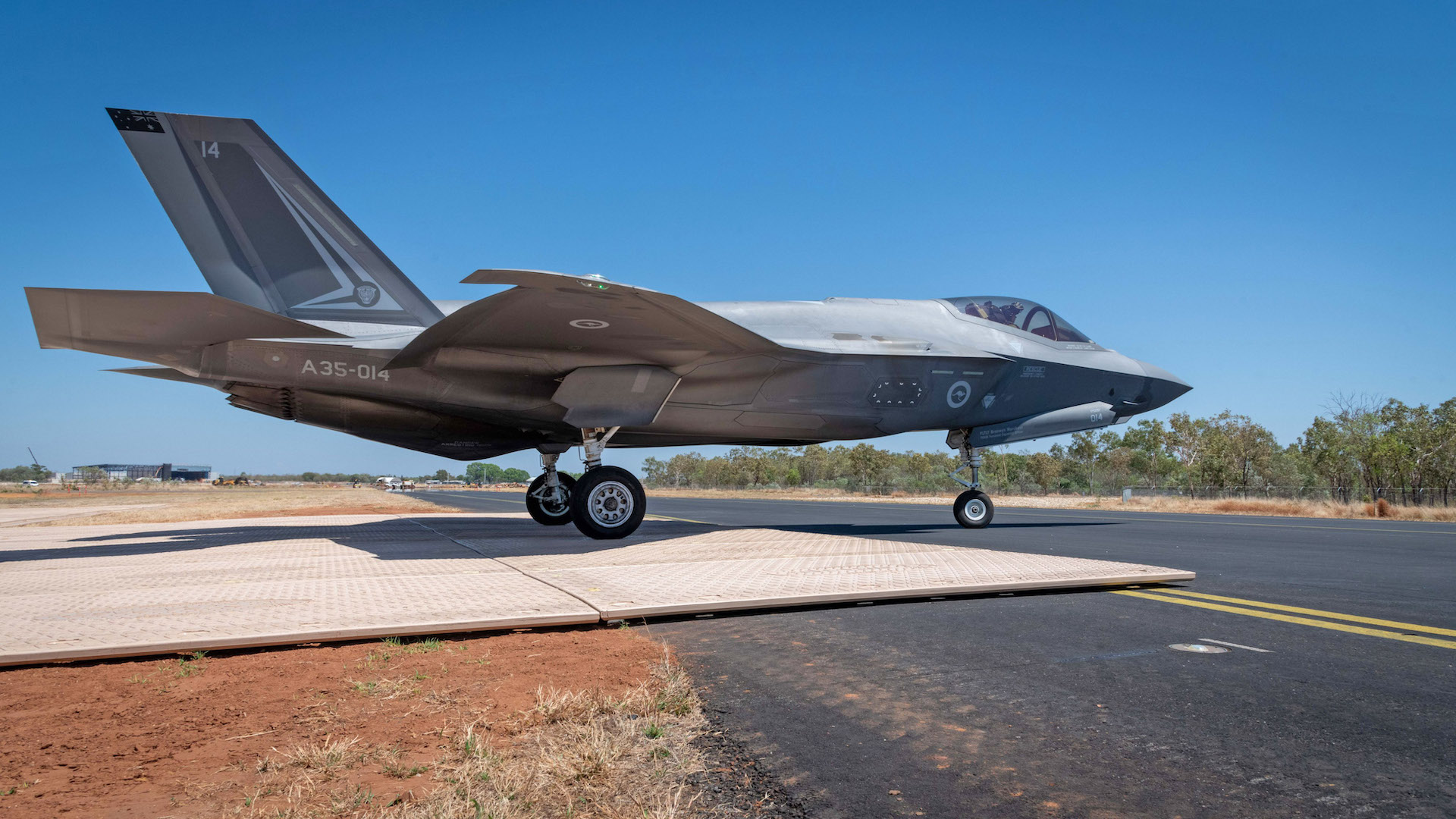

This article goes into the capability for expeditionary landing surfaces for the F35 and other aircraft as demonstrated at RAAF Tindal
