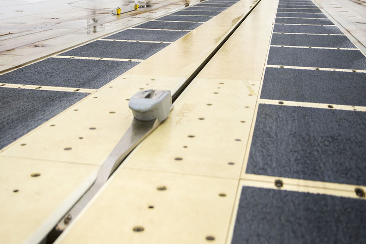

The UKMOD is looking at CATOBAR EMAL again. For what reason I don't know, but one has to wonder what they have in mind now.

Give the amount of upheaval anticipated in fitting EMALS back in 2011, which I'm told involved stripping the ship to deck one, and likely rebuilding the flight deck, one has to wonder. But the QE's are the only decks available for anything that big.

Indeed - which is why I'm so puzzled at the suggestion that the RN is actively looking at adding catapult and arrester gear of any sort now.
Unless they've got something in mind with a much smaller footprint?

That would be the obvious case, judging from the specification of the RFI that asked for catapult with significantly less max power output (max 25 tons) compares to not only the next-gen EMALS (at 45 tons class) but also the contemporary C13 (at 35 tons class), which suggests a much smaller system to begin with.
kato
25 tons? They'd have to significantly under-load the F-35s to launch them off of that.
Unless they intend to go with buddy-buddy refueling immediately after launch to get a core unit for a UCAV swarm up there, that's always a long-term view possibility...
wowu5
The implication I get from the number is that it's clearly envisioned for the use of UCAV only, except perhaps Rafale crossdecking in rare/emergency circumstance.
