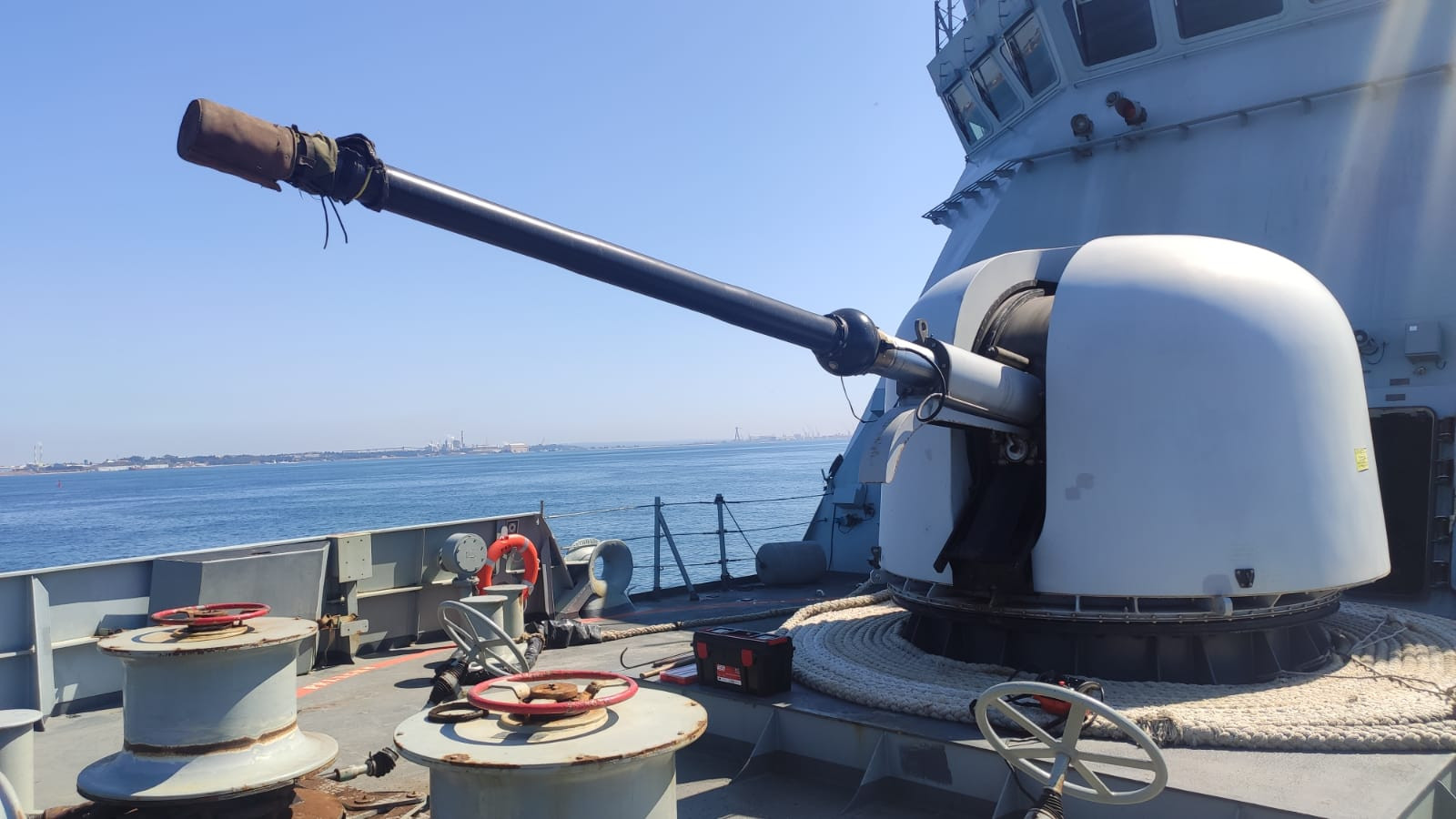

There has been a lengthy discussion on spanish sites about up arming the Meteoro class BAM OPVs, not dissimilar to the one around the Arafura class endured here.
Mission conceives the kit, not the other way around. Those vessel’s purpose is to be deployed instead of frigates in places like the Gulf of Guinea or the African horn to fight piracy and police around. They are suposed to bully most lightly armed OPV, stay deployed far from home, deploy its Infantería de Marina team if needed, support a medium helo.
It is a modern, hefty OPV. It can take on a variety of roles, but facing corvettes is not one of them. As a spanish Armada’s officer put it, “if a vessel engages in combat and launches missiles, it needs to be able to manage incoming equivalent ones” (can't find the source, sorry. It was part of a wider interview video)
Nevertheless, the threat posed by pirates and mafias has arguably increased with the affluence of elder missiles and improvised UAVs. It is not just light/medium caliber machine guns and RPGs anymore. There are two improvements that seem sensible and feasible enough, given the modernity of its sensoria and combat management system.
-Air-burst munition for its main gun
-Installation of Escribano M&E proposed TAO or french SIMBAD system, presumably replacing the two BAE Systems 25mm bushmaster automated mounts
(EM&E)
