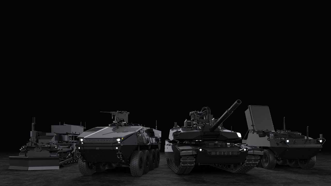

2023 is the decision year on it. GDLS clearly wants to green light the next step.
GDLS is clearly pushing They have just made a drop of the AbramsX with some details.
Abrams Sep V3 is already in service
Abrams SepV4 is said to be on the proving grounds with entry into service to start soon.
once that starts the Army will likely be looking at its next steps. As such 2030 doesn’t seem unrealistic.
OMFV is supposed to have full proposals due Nov1. Low rate for 2027 with IOC 2029.
The AbramsX is a weird endeavor. Clearly a demonstration of what can be done on an existing platform is wanted, but it's not at all sure the Army would be willing to fund anything after the SEPv4 that isn't directly related to the DLP.
This could be useful for export customers, but it seems directed at the US Army, not any specific customer. Otherwise, IMO, they'd aim for a demonstration abroad, e.g. Poland which became a new customer.
Terran
GDLS I think is trying to do for Abrams what Beretta tried to for the M9 pistol. Offer a Engineering Change proposal that meets the requirements of a replacement in hopes of getting a contract that would keep Abrams in house and in the army and not open the door to a replacement.

The AbramsX is basically a concept car fro a technology demonstrator. It shows what is possible and what the Army/GDLS is thinking about for the next gen American MBT.

The Abrams X is interesting because it is looking at new technology from an American POV. The US Army definitely wouldn't be that keen on it straight away because they are somewhat conservative. However it certainly does have some interesting features, some that undoubtedly could be utilised in future Abrams upgrades or retrofitted. The use of the hybrid powerplant is great and if they are able to have that running with the bugs sorted out, maybe it could be retrofitted into current Abrahms. The unmanned turret is another interesting idea and it may lower the profile. The combined 30mm and 7.62mm RWS on top of the turret needs some work because at present it is vulnerable to damage, but I suspect that definitely is a WIP. But we'll see and if the US Army is interested, the way the US Army manages its procurement system, my youngest grandson will probably be collecting his old age pension by the time it enters service with the US Army in the 2080s.
Perhaps I should and will edit to try and clarify.
these are as you also pointed out separate things. Abrams is at a cross roads, all MBT are.
M1A2C. I am not calling it the Sep 3 as the army has redesignated it with the additional alpha Numeric. This is the Abrams version in and entering the motor pool right now.
the M1A2D (sep4) which seems to be this
Is programmed by the army for 2025. It’s a systems update. But very much in line with the C. This is an incremental improvement.
Then we have the GDLS Abrams NG which is all guess work based on a viral marketing campaign. Which is I think a pitch for the talked of OMT, Using a heavily modified Abrams hull as the basis Targeting some time in the 2030s. An American MGCS, XM1A3, Abrams NG, Optionally Manned Tank, Decisive Lethality Platform.
What ever you want to call it. The hope for GDLS is an eventual successor to Abrams. GDLS seems to want to get in on it now presumably as an update to the Abrams system rather than have the Army run an open bid competition with potential of an Americanized K2M up gun or Panther Kf51 or some completely new wildcard MBT.

AbramsX is a GDLS name for a concept demonstrator about to be unveiled at AUSA. It’s not a program of record at this stage and it’s not a US Mil designation.

The three “Next Generation MBT” that have made the circuit in the last few years are not finalized product they are Technology Demonstrations of a potential future vehicle concepts. To date a number of Existing MBT have been called Next Generation or Fourth Generation MBT Altay, K2, Type 90, T14 Armata. In various levels of production or preproduction however none of these I believe is a true “next generation” beyond marketing. More of a 3.5 to 3.75 generation. An Abridged step. Of the Three concepts they I would say are similarly half steps.
AbramsX might form the seed of an M1A3 if the US Army wanted it or it might just be the start of a completely new Decisive Lethality Platform.
Right now. Abrams X is a pitch by GDLS for a potential transitional vehicle between Sep V4 and a successor if not a test bed for successor technology, with the US Army believing Abrams will be rolling around for at-least another 27 years an overhaul to serve between 2025-2050 after Sepv4. CBO: Abrams to account for 40% of combat vehicle spending through 2050 | InsideDefense.com
As such an Overhaul of the Abrams to bridge the gap until a true next American Tank. Like how the M60A1 became the M60A2 which was supposed to lead into production versions of the MBT70. Of course the MBT70 would fail. M1 Abrams similarly bridged the gap using a 105mm gun until the 120mm ammunition had reached maturity.

And this concept video from ages ago which shows 5 variants
The IFV, an APC with remote weapons station, What looks like a breaching version, a laser system presumably C-UAS and a reconnaissance vehicle with mast and antenna. Again seems the same vehicle as above just less defined. Now it’s not stated as an IFV or an MBT but the video clearly show a few more than 2 in the two man operated vehicle. Lending to the assumption of an IFV.
If there is another concept I have missed I would love to see it.
