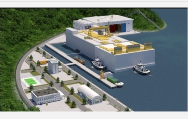

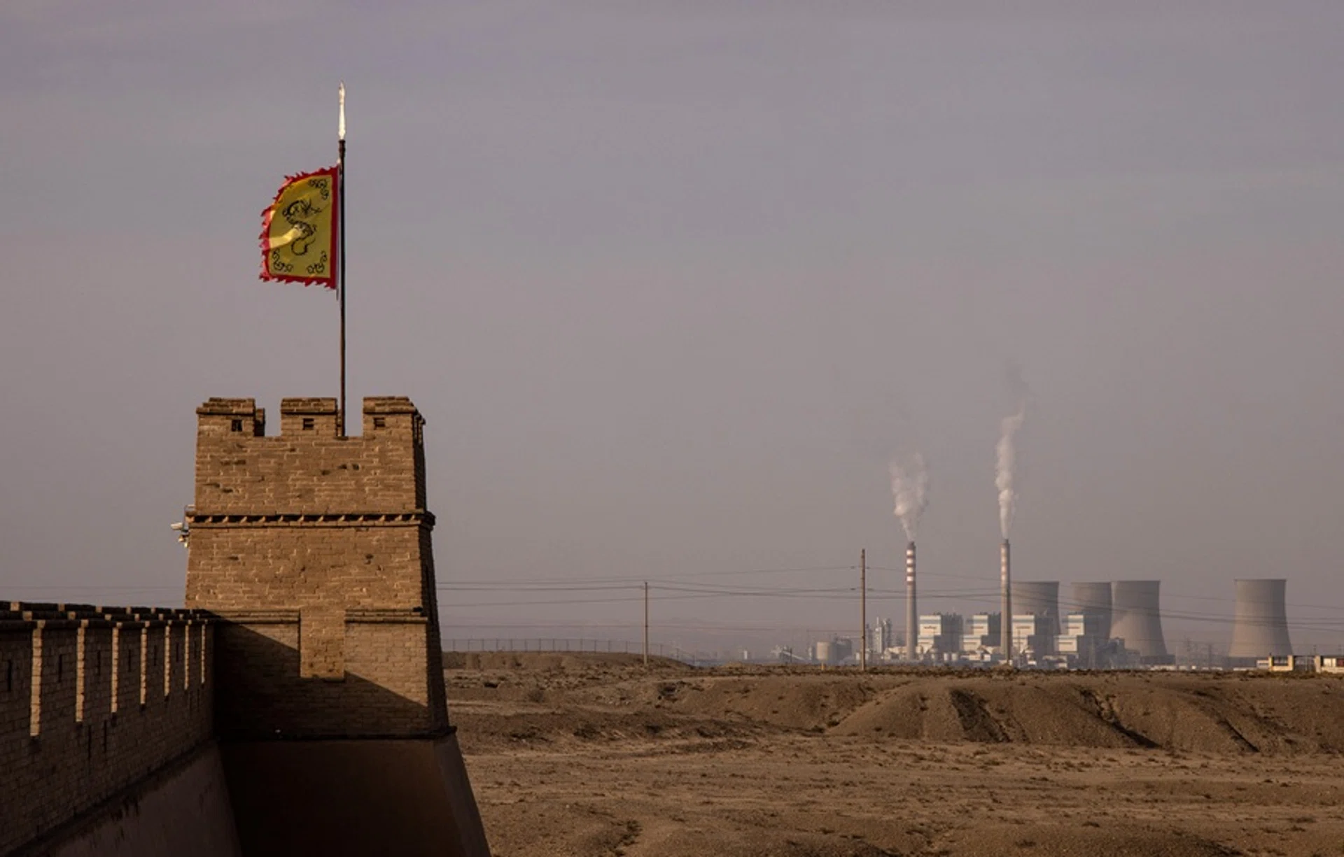

The key is Monazite supply and anti corrosion breakthrough that China develop. The article shown the stages of development from 2MW research, up to 100MW power plant. The compact nature of Thorium reactor enable them to be put in arid area where most China Monazite reserve locate as Rare Earth Minerals by products.
Monazite reserve is also what put Indonesia colaborate with US Thorcon on building molten salt reactor. Thorcon convince their technology of 2x250 MW power plant, will be ready by first half of next decade. Thorcon will use reactor on barges that be connected to each other as base on their reactors. Indonesian monazite reserve mostly come from by products from tin mining.
Still Thorium reactor tech as in development make Indonesia did not want to put all eggs in one basket for Nuclear power development. For that Indonesia nuclear agency Bapeten also in talk with Russia Rosatom on developing SMR.
Will have to see how Thorium Reactor progress developing as this is can be a breakthrough tech for more affordable nuclear power plant.
