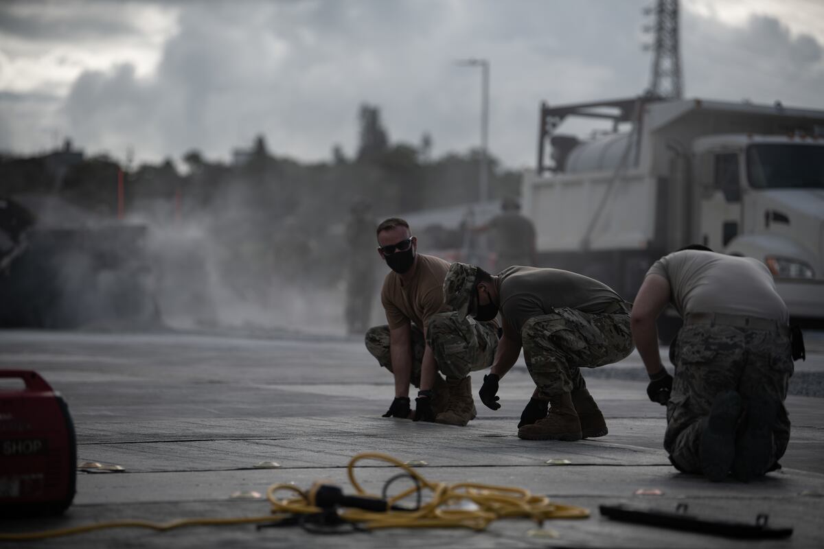

As far as I see it, the point of hardened shelters is to lessen the effect of surprise/short notice attacks or to defeat lighter munitions. In effect it "raises the cost" to the enemy to destroy your air capabilities. Iraq was a good example of this in the 90's, the coalition had to spend a lot of time and effort to destroy hundreds of shelters, some of which required two hits from 2000lbs bombs to crack. I believe large numbers of the USAF F-111's were used for this task.
In the Australian context, an outbreak of war within Asia would see a wide range of targets under threat. Most of the close USAF bases would be hit first (Guam, Japan, Korea) because they are closest and pose the greatest immediate threat. If this was combined with SLCM attacks on unprotected aircraft at RAAF Tindal and Darwin, Australia would be effectively "out" before a shot is even fired. I'm sure being a close ally of the USA, we will be on the list of potential threats in any wider conflict. So this is where some for of hardened shelters could come into play. Even just being able to defeat a SLCM, "raises the cost" to a IRBM or ALCM. Both of which could potentially be picked up by JORN (or any future IADS/BMD) and hopefully engaged. Either way there are only so many IRBM's/bombers to go around, so I'd imagine the "destroyable" targets would go first.
Someone else would have to answer but the thinking appears to be that anything struck can just be repaired in a timely manner if the resources are given to do so. Roads, bridges, hangars and runways to my knowledge can be repaired fairly quickly - or at least quick enough to continue supporting logistics in a useful manner. Compared to the destruction of deployed units, it may be less of an issue. With regards to RAAF Scherger, it appears (barring a few particular contingencies) that RAAF Townsville and RAAF Darwin can facilitate RAAF operations in North Australia and North of Australia, should it be needed. Forward posting a handful of surveillance or patrol aircraft to RAAF Scherger is not going to strain the road network as badly as fighters or bombers in combat operations.
RAAF Townsville was developed in WW2 because it was "not to far, not to close, it's just right" from the conflict to the north. So yes it could be used to support operations in North QLD, but its still a long way south of the "tip" (over a 1000km in a straight line). This is why Scherger was built. In WW2 there were bases throughout the Cape, most of the civil airfields today are what's left (Bamaga, Horn Island, Lockhart River, Cooktown).
Even 1 Squadron of Hornet/F-35's will use a reasonable amount of fuel in combat operations. Your average road train can move around 120T of fuel, an F-35 has internal storage for 8T. So effectively you'll need two 120T road tankers (both over 50 metres long), just for one sortie. That sort of traffic will quickly destroy a dirt road, and in the wet season may be impossible to move at all. That's all assuming there's no opposing forces capable of destroying the road convoys over a 7-800km journey. Hence my reasoning behind "reasonable" infrastructure upgrades that also have a significant civil benefit as well. After all, what's the point of building Scherger if the supply lines are useless?
I'll concede your point that roads, bridges, etc can be repaired reasonably quickly, but some of these links barely exist in peacetime, let alone during a conflict.
