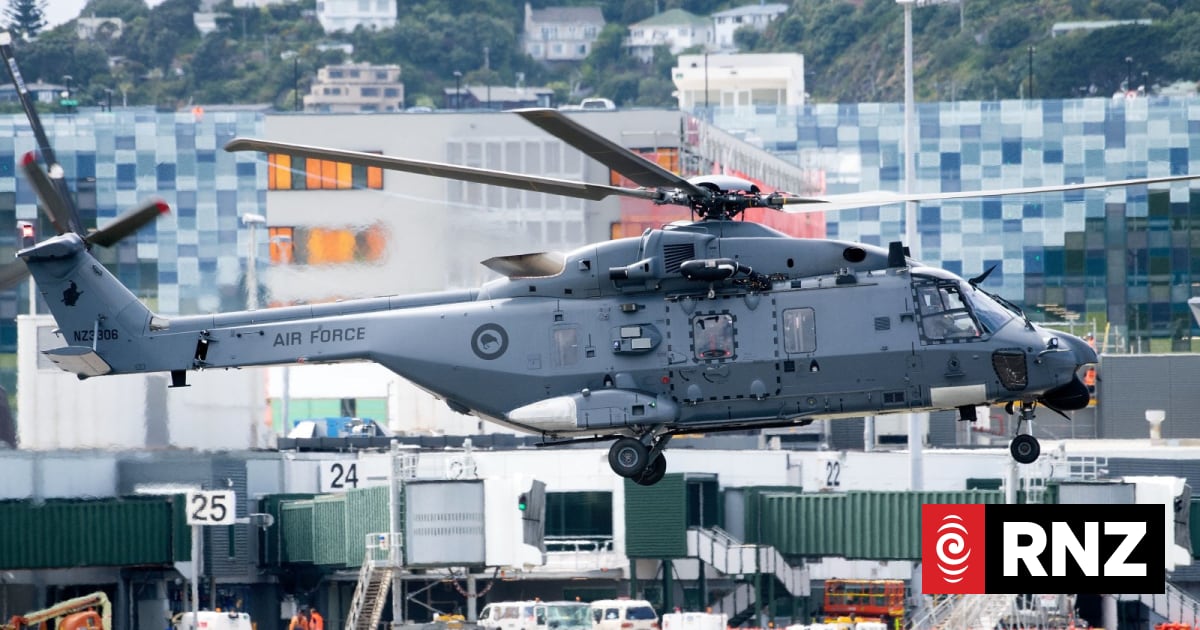

Radio NZ News item on the NH90. The article has links to the different sources for its info. It gives the RNZAF availability for the type, which sits around 75%.
Very informative article from Phil Pennington (kudos to him). Seems to be no major issues flagged in regards to availability and support from Airbus (although perhaps one oddity in the article is where it mentions they may need to be flown for more hours than the manufacturer recommends to maintain aircrew skill levels for the numbers of airframes available - however that's based on the Cabinet papers projections from around the time of purchase (2005/06-ish?) and presumably the recent purchase of a CAE NH90 full flight simulator will help alleviate that).
However the article also signals "interoperability with Australia" will become more difficult and defence "may explore options in future". But it's probably way too early to be thinking of alternative options at this point in time, if so expect the NH90's to be around for a while.
Another, more relevant fleet to follow imo, is also the Spanish air force as being one of the newest to transition so no doubt having all the latest upgrades and having the benefit of operation, lessons learned and experience from their army counterparts, the OEM (literally next door) as well as the other users worldwide (Good and bad) should arguably be at the top of their game in the peak of its performance (so far). So far they seem to be happy so I assume they applied all that gathered knowledge and hit the ground running, avoiding known obstacles and using best practice.
In addition it appears that Qatar are doing well and also have an average serviceability above 80%.
It still seems really odd that some nations are experiencing really major issues and some are not. Is it to do with the support arrangements? But if it were then surely that could be addressed. Very strange, still.
Is it really enough to support a brigade?
The supporting Cabinet papers (linked to in the RNZ article) talk about lifting a 3 section platoon (typically on an overseas deployment) requiring 3 medium lift helicopters. 3 NH90's deployed would give 51% availability, but 4 NH90's deployed would give 82% availability (5 = 94% availability) for the 3 NH90's required for the platoon lift.
As a number of us here have been advocating (i.e. for the defence review) that the NZDF needs additional medium (or heavy) lift helicopters (and personnel) to allow for concurrent deployments. In the meantime the AW109LUH provides backup domestic CT roles should NH90's be unavailable domestically eg if most were tasked for overseas deployment (the AW109 also provides some command and control for the NH90's and usually work together).
At the end of the article it says "Defence faces another big chopper choice: A $1 billion-plus replacement of its eight Seasprite frigate helicopters. A tender would go out soon for proposals, it said".
