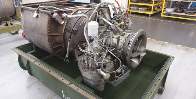

The M1 has a turbine engine. It is not a "jet engine". Turbines do not require jet fuel. All tactical vehicles in the US military run JP8. It's a logistics decision, not a mechanical requirement. Prior to 1990 all those vehicles ran on diesel. If M1s are donated to Ukraine they can easily be set up to run diesel
The AGT15000 is a multi-fuel engine and in addition to JP-8, it is able to run on diesel #1 and #2. That said, different types of fuel have different levels of viscosity and volatility (combustion). Engines and engine management systems are usually tune to a certain range of fuel to achieve optimal efficiency and reliability.
While the AGT15000 can run on diesel, the question is how that impacts the reliability and MTBF of the engines. We do have data points on this. The Australian Army appears to run their M1s on diesel (not sure #1 or #2) but MTBF has not been as high as the US Army/USMC. More importantly, it requires dedicated facilities to maintain.
I think the concerns about logistics and maintenance are valid. MTU is next door in Germany. Leopard tank engines (MTU Ka501s) can be overhauled there. If they bring the M1s over and running on diesels, in all likelihood, they will have to come with a ton of spares engines for field swaps, since there are no D level facilities in Europe until the Polish facility comes on line.
US/NATO has been looking at the single fuel concept (SFC) for a while. But in practice, that's another story.
Turbine engines and jet engines work on the same principle and as long as the fuel control unit is set up correctly they will run on just about anything that will burn. now days with electronic fuel control units it is quite simple, but even older engines were adaptable. I remember reading spec's when I was in D Eng that the then navy Wasp helicopter could be set up to run on ships diesel. When went to US bases with the Skyhawk we had to change from F34 to JP8 which was just meant moving a leaver from one slot to another. The only difference was a slight drop in range due to the lighter S.G.
Yes, it will run, but the question is what that does to the engine on the long run, in a region where there are no maintenance facility.
Personally, I am skeptical of the multi-fuel promise. If electronic wizardry alone can solve the difference between different compression ratios of diesel and gasoline, we would all have an easier time at the pump.
GT's run fine on quality fuel, without much regard to what that fuel is - there are other complications for aircraft, like anti-static additives and so forth, but for a tank or other ground vehicle running at sea level or near enough, running it on JP8 or diesel makes no difference.
GT's have basically been multifuel since their inception - the way they work makes them relatively agnostic about what they're running on - as long as the fuel selected is free of contaminants and so forth, it's not a big deal.
Just remember that the gas turbine runs on a continuous burn cycle not the Otto cycle of a piston engine ( it is similar to a continuous Otto cycle) and once running does not require the high compression of a diesel engine for compression ignition or spark plugs of a gasoline engine.. It requires the right air fuel ratio to extract the most energy available from the fuel it is using. The reason that Gas Turbines use a lot of fuel is to keep the temperatures in the engine under control (cooling) and up to 80% of the power of the engine is used to supply air to the engine for cooling and not combustion. this figure has been improving over the years as new materials have allowed the engines to run hotter. As long as the fuel is clean, what the fuel is will have little impact on either the performance or maintenance of the engine.
From an application POV, the diesel and GT both utilize similar fuels as per above so the main advantages for diesel are reduced consumption and fewer tanker vehicles required for fuel logistics. I think my earlier comment about more available diesel mechanics is also valid so this what makes the Leo2 a better option but as others have pointed out there aren’t many available for immediate use. Perhaps the US should match any Leo donations with M1s and a tanker vehicle.

1) M1 Abrams doesn't have jet turbine, it has gas turbine. And yes, it can run on many types of fuel. However...
2) Modern diesel engines have multifuel capability, so that "runs on many types of fuel" bit is no longer an advantage.
Obviously, both engines run best on the fuel they are designed for (JP-8 for Abrams, diesel for Leopard), but they can use other types of fuel.
Wondering how forgiving wrt to $hit fuel GTs are compared to diesels? From my experience with marine diesels, 95% of all problems are related to water/contaminants in fuel.

For all the continued talk of running M1s on diesel, according to reporting in 1989 when the US Army was transition their M1's from DF-2 to JP-8 the change resulted in reduced fuel economy. https://web.archive.org/web/2023012.../news/ct-xpm-1989-09-01-8901090654-story.html
That's right, the M1 ran better on DF-2.
Additionally, my understanding is that the Australian Army feeds their M1s a hearty diet of diesel
Push comes to shove, I'm willing to bet the Ukrainians will be able to run M1s on a mixture of sunflower seed oil and captured vodka. /sarc/
