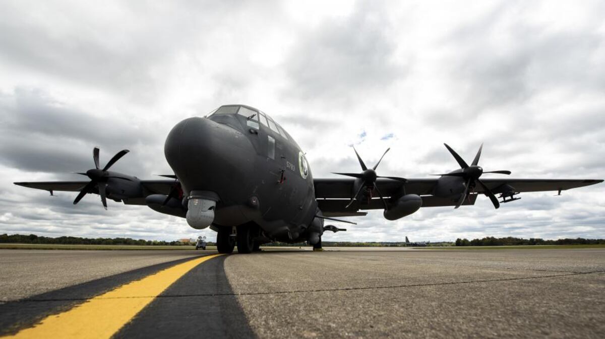

The USAF has recently shelved its plans to build a gunship version of the C-27J due to funding, and instead will be be giving some MC-130s gunship capability and converting a number of C-130J airframes to AC-130s to replacing aging aircraft.
Since LIC/CI warfare seems to be with us for the forseeable future, I'm curious to here people's opinions on the future of fixed wing gunships.
Will we see a replacment for the AC-130? Are directed energy weapons likely to make an apperance as gunship armament any time in the near future? What about UACV gunships? Do any other nations have interest in developing fixed wing gunship capability?
