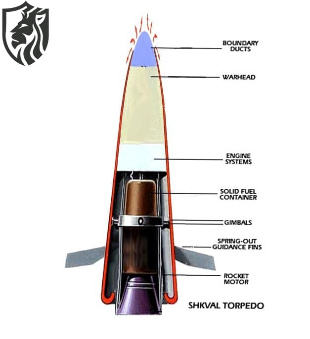

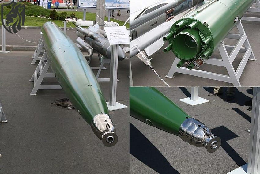

Shkval’s design uses a nose device (often described as a cavitator) to start and stabilize the cavity. Moreover, designs discussed in open literature describe gas management to sustain that cavity as speed increases. This is also why guidance is challenging. The bubble isolates much of the body from the surrounding water, so classic fin control becomes less effective. As a result, “turning hard” and “homing precisely” become engineering nightmares.

Most accounts describe a two-step problem: first reach supercavitation speed, then sustain it. Shkval reportedly accelerates quickly after launch, then uses rocket-style propulsion to keep velocity high. That concept explains both the appeal and the penalty. The torpedo arrives fast, yet it also creates a loud, turbulent signature. In other words, the weapon announces itself.
